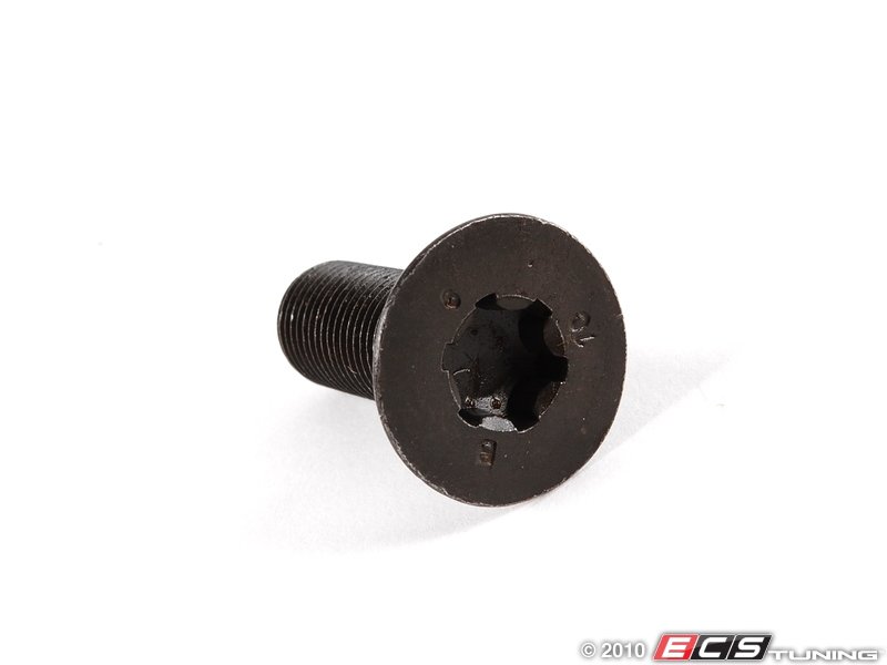

Currently planning to replace the timing chain on a Mkv gti tfsi. Looking for a D.I.Y write up on this replacement. From abit of online search I think you need a special tool to hold the cams in position? I couldn't find a proper write up with photos, any links to related D.I.Y would be appreciated or advise??:idea:
No need for the special tool to hold the cams in place, you can stop the inlet cam from turning by inserting a piece of flat bar, or the end of a spanner into the end of the inlet cam.
Your biggest issue is going to be the bolt that holds the exhaust camshaft adjuster onto the cam. The 1st problem is you need a special bit called a Ribe or Polydrive bit, which looks like this: Image
And here is a picture of the bolt:
The next problem is going to be that the bolt is EXTREMELY tight, so chances are you are going to strip the head of the bolt like I did. I spoke to a VW mechanic and he says this happens often to them.
Otherwise it's not such a difficult job. Just make sure you mark the position of both cams so that you can get the timing right when putting the chain back on.
Here are the only pics I took.
Bolt head stripped, which meant I had to drill the bolt head and then hammer a spline bit into it.
New chain and tensioner
